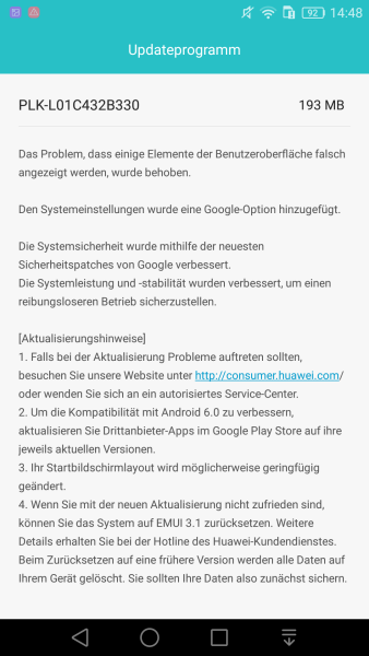

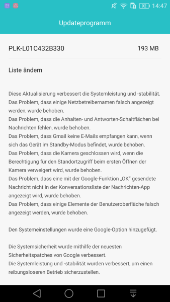

Screenshot_2016-03-24-14-47-52-e1458830411140.pngScreenshot_2016-03-24-14-48-00-e1458830421670.png
