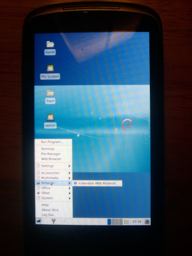

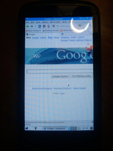

Debian funktioniert auf dem Nexus One.

This is a method to boot into Debian via fastboot on the nexus one from
your SD-card. This is NOT a chroot Debian image, it is honest to goodness
Debian running directly on the hardware. This is completely non destructive to
the android OS. Connectivity to the device can be provided by adbd, ssh, or
serial console. Wifi works perfectly. I have not tested bluetooth. Touchscreen
works, but needs tweaking. X11 works in framebuffer using the Debian
testing branch (squeeze). In order to get a full fledged X driver with
3D acceleration we'll need the driver from
https://www.codeaurora.org/index.php?xwinp which I haven't been able to get
to build. This doesn't mean it's broken. It just means I suck
at cross compiling.

After I installed xfce4 I was able to get X on the main display by
simply running startxfce4
# startxfce4
By default Debian is configured to only allow root to startx.
If you want to be able to run X as a user edit /etc/X11/Xwrapper.config
*note* even with this I haven't been able to run X as a normal user.
Only root.
Change allowed_users=console
to allowed_users=anybody
Currently touchscreen is a little weird. It feels almost like using a
laptop touchpad. The mouse moves much faster then your finger and tapping for
click isn't enabled by default but two finger tap will right click. You can
also move the mouse with the trackball. Clicking the trackball registers a
click. But you have to wiggle the trackball just a tiny bit after you click to
make it register. I am going to work on tweaking the fdi policy files to
make things a little more usable.

Screenies! http://picasaweb.google.com/JairunCa...eat=directlink
